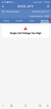

On charging the system I get "Single Cell Voltage too high" .
On the individual cells one is 3.53 v compared to an adjacent one of 3.43 v
Am I perhaps pushing the battery too much or is it possibly a bad cell from the factory?
Any suggestions?
The individual cells should be balanced by the BMS, but perhaps one has a fault? Worth contacting the seller of the battery?

Leave it charging on the ip22 for a good few hours to give the BMS a chance to balance the cells. Then discharge to about 20% and recharge a few times to let it all settle and calibrate. If that doesn’t work then possibly something isn’t right.
Cell over voltage normally pops up when the charge rate is a bit high for the particular battery....
You can try tweaking the settings a bit.
Start by dropping the bulk charge voltage by 0.2v steps on all your chargers and retest. (So the profile in the ip22 and mppt)
I had similar on my power road batterys.... Dropping the bulk voltages helped slow the charge rate down enough to stop one cell peeking prematurely.
