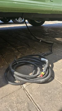

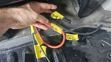

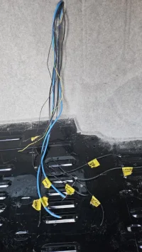

Following on from our disaster (link above to that story) I'm trying to work out where the conversion company were planning the leisure battery and diesel heater fitting. Here's the cables that were run, and I know that we were having solar and 240v hookup. And the starter and leisure batteries were going to be charged from solar and mains. The alternator/starter batter would also charge the leisure battery while driving as well.
Any best guess at where the leisure battery and heater were going to be installed?
