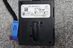

But if I change the kessy module without making the adaptations I can at least start the car? But I won't be able to unlock and lock the car with the remote control that's right ?

Hi, You have a video of your car with the VIP open function. Thanks
Good evening I managed to correct my problem regarding the error message (basic setting) and now the car opens with as before but I can not operate the tailgate with the vip function so open easy. There are coding to be done and adapted

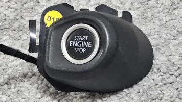

Interesting mod.
But not for me, too much Of a security risk in London. To gain entry. (Relay attack). Thou is suppose they won't be expecting it to be keyless anyway.
But I see you opted to still keep the steering key lock.
Keep us posted with the work.
