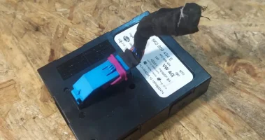

Because we need to get the VIN of the CAR into the Kessy Module.
People sell this service.
From what i see they probably externaly read out an eeprom and change the VIN, that is it.
The Keys and other stuff of immobilizer are not in Kessy, they stay in ECU and Cluster.
Open Questions:
- Which Door Handles with Kessy support do fit the T5/T6 Mechanicly ?
- In my Head the Retrofit will only use the Keyles Entry option, KeylesGo will need a compleete change of the Steering column, that i am not interested in ....
no need strip down kessy to change VIN inside, it will not work
you still need adapt Kessy key , so all you can do via OBD

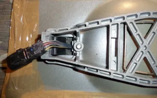

the best one for "DIY" is Golf PLUS , because they are ony one who use pull stahlkabel to open door lock
all other pull lock mechanism inside a door to open door, so they have no space to mount stahlkabel
Golf PLUS door hande is too long to fit into the door
I made my door handle 4 years ago like that ,
you can see more pictures on movie
this is for Touran 2005

Hello, I have a question concerning the kessy module, what is the procedure for changing from version E to H (coding, vin, adaptation ???). Thank you
If you change kessy module then the "basic adaption" needs to be done. Which basically means that your VIN has to be learned. This can be done quite easily with, for example xHorse iScanCar MM-007.
