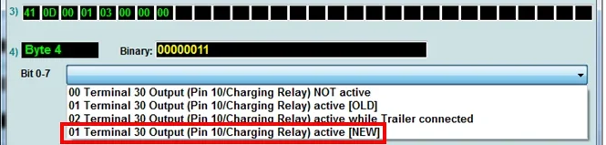

First up we need to amend the behaviour of pin 10 in the trailer socket. Ordinary behaviour is ignition live (or more specifically engine running live I think) when trailer detected. This can be changed in the trailer electrics section in VCDS Byte 4 bit 01 as below screenshot:-
THEN this happens:- pin 10 in the trailer socket is now ignition/engine running live (irrespective of trailer present or not).

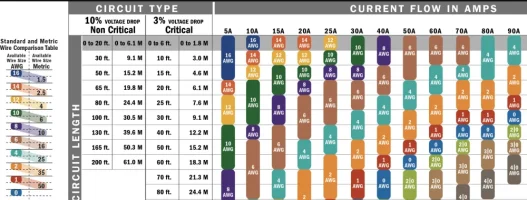

It is little bit weird. Look into any recommended amp chart such as the one below, consider the wire lengths to reach the caravan and you'll see 10-15A would be the recommended max current flow and effectively that would translate to max 8-10A charger on caravan. I think they have used 30A fuse in order to withstand pretty heavy voltage drops for a short while. Even so, using only 2.5mm wire with such a fuse on an expected long wire run feels reckless from VW.
Very interesting @n10n thanks for that - useful chart that. As you say, a bit close to the limits that!!
