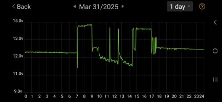

Both my Vans rest voltage is around 12.1v to 12.2v
Based on the BM2 voltage loggers.
