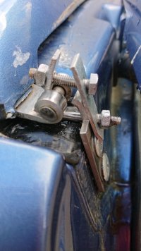

The nearside hinge of our HiLo surf roof has just popped off! Has anyone else had a problem like this? They are held on by 2 rivets and I'm not sure how to go about fixing this... Any thoughts (on the repair)? I think it will need to be a 'blind' repair in that I can't get into the back of the attachment point. A high stress point at that. I'll post some pics when the van limps home... Obviously it did this when I wasn't in it.

So I got sent some photos and it turns out to be the hinge itself that has failed. This is even more serious than I thought. I would say the chances of fixing this might be quite slim. I've not seen it in person myself but these pictures probably tell the story.
Apparently it snapped as the roof was being lowered and 'landed' at this ridiculous angle.
With some additional assistance it was possible to shift the roof into position and lock the front down. Which avoided a breakdown truck.

To update this thread, in case it's relevant to anyone, and to save some of the head scratching if you find yourself here:
Jason at Jaibow very kindly offered to send me a hinge (and spent some time talking through the options). Here's what the original / spare looks like (Jason's photos)
The sharp eyed will notice that HiLo installed the hinge 'inside out' - Always possible that puts additional stress on the short arm because it's essentially sitting backwards from its design position, but that's just my opinion, not engineering fact.
But looking at that made my eyes water - replacing the long arm means raising the roof (or removing it) and finding a way of detaching it (I think it was set in resin, but I might be wrong).
Option 2 would be to take out the pin and swap the short arm, putting a new pin in my hinge on the van. But that means (at least) taking the rear door off to get at things comfortably, and removing the short arm from the van.
I had a long and helpful conversation with Ady at Crystal Custom Campers to discuss how to replace that hinge and that highlighted a problem, which is access to inside of the rear frame where they drilled to put the rivets through the short arm. Basically you can't get at it, so no hope of bolting it. So there's a risk that by drilling out the rivet that is a 'terminal solution'.
Bear in mind that the gas strut is trying to extend (which is why the hinge is skewed in my original image in the previous post) - so I'd have to deal with that and support the roof somehow, and align the roof precisely.
These factors put it beyond my capabilities and we were going away in the van for a few days, so I had to do something...
My approach (for which read bodge) was to fabricate a temporary bracket by drilling through the short arm and bolting above and below. It's neither pretty nor functional (I can't open the roof) but at least it is safe to drive. Camping in it is less fun.
I will tell you it's a really fiddly place to work and the clearances for a drill and spanners are marginal (without taking the rear door off) - as you can see from the paint. That took me about 4 hours - maybe a sign of my incompetence.
