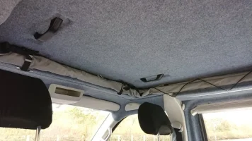

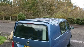

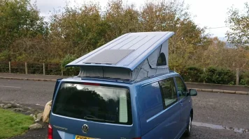

A huge round of applause to Vanmax Poptops…They took on the challenge and were more than equal to it. We have now got a spanking new roof that doesn’t leak, has no condensation build up and doesn’t self harm. In fact, it is a better product even if the Surf roof had been as advertised. It is approximately the same height profile and gives slightly more headroom inside when closed, is a wider aperture and gives plenty of height when open. It is much easier to open and close than the Surf and runs more quietly on the road - no creaks or groans (from the roof) on uneven ground either.

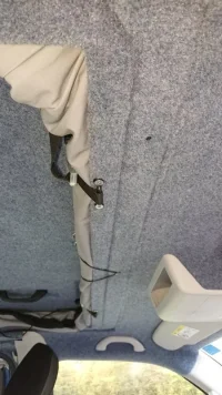

We have no roof bed (hence the higher headroom when closed) and had made a particular set of choices, all of which were more than satisfied by Vanmax. Notably, we asked for midge nets (very fine mesh!), which they chased down, and then exceeded our expectations with a method of stowing the canvas.

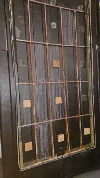

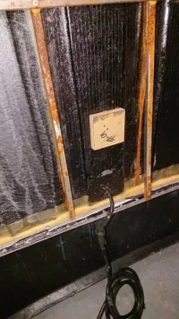

In order to retrofit this, Vanmax ripped out (very carefully!) the whole Surf roof and frame, stripping it back and cutting a wider opening. [Please note that the "in progress" pictures were supplied by Vanmax]
The Surf cut-out was offset further forward and they thought it might need additional plate at the front, but because of the cunning “cassette” design of the Vanmax, this proved unnecessary.
The nose-cone design also means that those holes in the front are never to be seen again – so no remedial bodywork required. The lighting was dismantled and re-used and the existing back cupboard was minimally adapted – it might have been more difficult if we’d wanted a roof bed. Rather than spend another £400+ on a new headlining we decided to live with a spliced carpet in the cab (and HiLo had wrecked the finish of the original anyway).
The work took 3 weeks, but this is in part due to the “experimental” nature of the job. Since picking it up from their workshop I’ve driven 1,000 miles, camped 2 nights in it and operated the roof 10 times. Obviously this is early days, but by this point with the Surf it had leaked like a teabag, abraded both sides and cut itself holes in the canvas, and been as breathable as a plastic bag. So, the prognosis is good. Vanmax were excellent to deal with, thoughtful, flexible, helpful and willing to find a solution in difficult circumstances – they are about 370 miles away for a start! I made a deliberate choice to go directly to a manufacturer rather than a fitter after lots of conversations. Given the way the Vanmax is built, my guess is that a good fitter would now be able to do the same job with a Vanmax now we have “proof of concept”.
