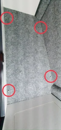

I’ve been attempting to access the electrics in the rear wardrobe of my Birchover to install an MPPT solar controller but I’ve fallen at the first hurdle. I removed the four screws (circled in red in the pic below) that I understood were holding the cover panel in place. However, after removing them and using a trim removal tools to lever the panel forward, it still won’t budge.
I’ve looked for other screws and hidden fixings but couldn’t find anything. Can any Birchover owner who’s removed this panel confirm these screws are the only fixings holding it in place or is there something else that needs to be removed? Any input would be very much appreciated. Many thanks.
I’m hoping to install a Victron Energy SmartSolar MPPT 100 /30 controller in there… up in the centre at the top if it’ll fit. Its depth is 70mm so it might not be feasible to put it in there. The fall back location is where the present CBE 516-3 EHU charger is installed which I’m planning to replace with a Victron Smart 12-15 IP65 charger but locate that down near the fresh water pump.
I put a Victron on the other side of that board, so facing into the wardrobe as was advised they can cool easier that way. I also didn’t have the space you have on top of your pic
Mine is 75/15 MPPT
If it’ll fit inside then I’ll probably put a mesh-covered vent at the top of the panel to get some airflow. Otherwise, I favour siting it where the present EHU charger is as I really don’t want to put it inside the wardrobe. The 100/30 unit is rated at 98% efficient so I’m hoping that it won’t run too hot.
