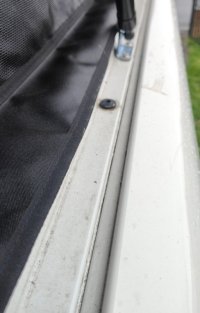

Here are the photos of the roof channel with the pop top up.
Looks like a standard remo rail will bolt straight on.
Or a c-rail, but this will need to be selected carefully, and will need cutting and modifying to fitted around the pop top brackets and make sure it doesn't fail anything.
