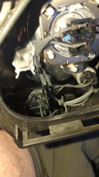

Thank you for your input you are spot onI think it rotates 90’ then pulls out. I did mine with the headlight out and it was still difficult as the angle is awkward.

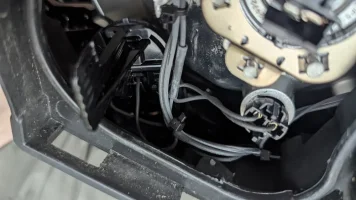

No, didn't need to, just enough slack to do the job.Ps, did you guys cut loose the tie-wraps ? And put them back when DRL is installed?View attachment 251154
After 2 nights of sleep it worked for me as well. Thanks!No, didn't need to, just enough slack to do the job.
