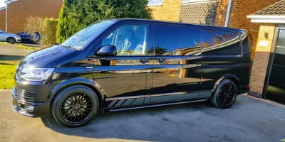

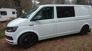

Mine is very tail high, the 15mm difference looks much more across the whole whole length of my van. Your Kombi looks quite balanced front to rear.
It's interesting that they sell springs as having a given drop over standard , especially as my Kombi was like it was on stilts against all the others I looked at. I know that there's a big variety of weight carried but it would be helpful to have a better way of knowing how your van is going to look with the various different springs fitted.

Sorry. I thought it might, but you have to take into consideration what weight people are carrying, specially if they are full campers. Mine is boarded out for work purposes using 18mm ply, and I always have my kit in the back, but I wouldn't say i'm anywhere near my max load.
Just shows you there can be very little difference between the 30mm and 50mm springs in certain vans.

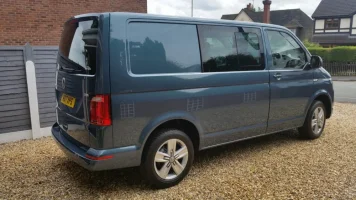

I fitted H&R 50mm lowering springs on my T28 a couple of weeks ago.
I'm really happy with them. I was expecting quite a harsh ride, but it's not at all. I'm still running standard 16" rims / tyres (with 20mm spacers), and whilst the ride is firm, it's still supple enough to absorb general bumps comfortably. I agree with BenBoy that it does bang a bit over pot holes though! I'm still running standard shocks with no issues.
That looks nicely balanced Dubya, and reassuring that its not to harsh a ride, my bus is booked in next week for the same and I have been assured it will not need to be realigned, will take a before and after photo and report back on my verdict.

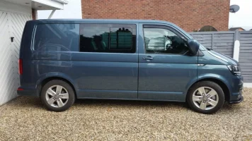

H&R's and front splitter fitted just two weeks ago, and can only say i am well satisfied with the improvement to the ride, although a bit more bumpy, I have been told that the upgraded anti roll bars will make even more difference ? (might try that later on) . I think the ride heights, are all subject to certain factors such as wear on shocks etc, however mine are now 415 front and 423 rear.new before.jpg new after.jpg Top image before, bottom after (if you could not tell)
Looks great ......Im getting mine done next Saturday and cannot wait ! :thumbsup:
