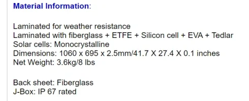

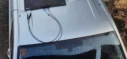

well heres a day in the life of a 110W semi flexable panel with me....
its a tough life in this house, trust me . . . . . . .

Is there enough flex in one of those panels to follow the contour of the windscreen?
you get about this much cable on them . . . .
possibly . . . . just.
they are very stiff. ( 4mm fiber glass board type stuff)
and not relay meant to be massively bent. ( but will bend slightly if bonded to a slightly curved surface)
solar cells are basically glass wafers after all.
bend them to much and the will break or the bond wires will snap.
