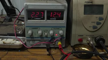

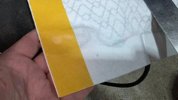

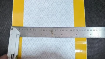

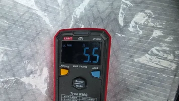

My passenger seat heating has been acting up intermittently. The OEM heating elements (7E0963557C, 7E5963555) cost a fortune these days, so I decided to replace the faulty one with these aftermarket alternatives (€5.25 each).
I’ve already bought four of them. I will, of course, be transplanting the OEM temperature sensor onto the new pads to keep everything working correctly.
TBC ....
View attachment 315413View attachment 315414View attachment 315415
TBC ....
