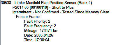

Hi,
I have a VW T6 2016.
I had problems with the intake manifold (Code P2006) and it was replaced with a new one. But now I get the fault code P2017.
Can anyone help me with a solution to this problem?
is it possible that it is the solenoid valve that is broken?
Greatly appreciate any help!

Please post full engine section of the scan - lessens guesswork what engine it's all about.
Anyways, usually the fault code indicates missing earth (negative) connection - thus a wiring fault.
