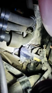

I don't have the tool to pull a vacuum but after doing some research it seems it could be the valve that pulls the vacuum so going to take it back to the garage tomorrow and ask if they checked this before replacing the manifold!

New N75 valve fitted and all good it seems. Who knows if the manifold was the cause of the fault but it certainly needed changing with gunk approx 5mm think built up inside.
