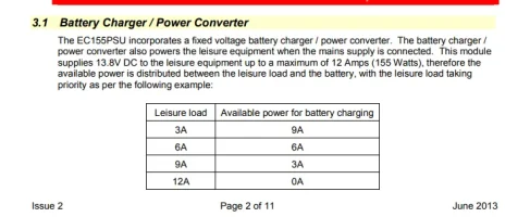

its just a 13.8v fixed output upto 12A - not a battery charger.
so depending on what loads you have and what power is being pulled to run them.
the remaining would be left for the LB.
Not ideal and not a charger, also no charge back to the starter. - so every time you unlock or lock the van or the internal lights come on you will be depleting the starter battery.
3.1 Battery Charger / Power Converter The EC155PSU incorporates a fixed voltage battery charger / power converter. The battery charger / power converter also powers the leisure equipment when the mains supply is connected. This module supplies 13.8V DC to the leisure equipment up to a maximum of 12 Amps (155 Watts), therefore the available power is distributed between the leisure load and the battery, with the leisure load taking priority as per the following example:

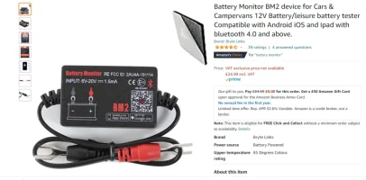

have a look at the "battery monitoring" thread above.
look at fitting a simple monitor - like the BM2.
then you can see whats going on with the battery, ie charging, draining, flat. full etc etc.
FYIW - i have two, one on each battery, starter and LB.
example BM2 -

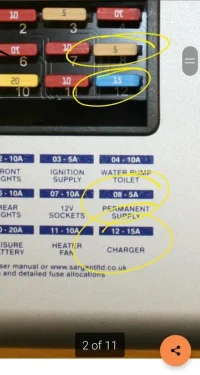

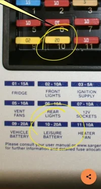

Have you checked all the fuses?.
Check one at a time.
Especially number 10 ....
example BM2 -
Thankyou for this- I have been looking at various different ones but will take on board your suggestion.
