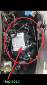

I have T6 and Coolant System is Faulty. Everyday Level went down and lights comes on dashboard. every next day when I started the engine and then when I open Coolant Bottle Cap then Level comes up. Dealers couldn’t find the fault i don’t know what should I do ?
What engine exactly?
The cooling system needs to be manualy pressure tested on cold/hot engine.
That will show you where leak is.
Possibly via EGR cooler and ingested into engine when running.
Thank You for reply me quick.
The Engine is
Shuttle SE LWB EU6 150 PS 2.0 TDI BMT 6sp Manual. Dealer was tried everything also they replaced some new parts then after same problem. Couldn’t find the Fault after 20 days.
can you show us some pics?
so if you fill the system to the full mark on the expansion tank . . . . . how long/miles till it shows low/empty?
what you got any white smoke out the exhaust when the engines warm?
have you got all the airlocks out the system?
Forgot about how many miles. If I keep car Two Days Continues at any place so Tank went almost empty and doesn’t Comes level on the top when I open the Cap. But when engine become hot so level is comes on the top little bit when I open the cap.Dealer said there no licking found also all pressure checked.
Replaced Which showing in the Picture
