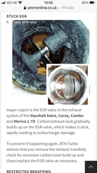

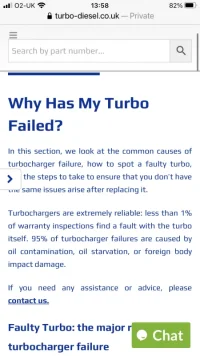

I have since found a lot of information contradicting that and the EGR can be a main contributor to turbo failure.

P.S. EGR failure isn't usually a cause of turbo failure directly, oil issues are a common cause of turbo failure. The reason the egr has been thrown in with turbo issues is that egr issues frequently show up as a boost fault as they are depended on the exhaust gasses for operation. Open egr fault = underboost, stuck closed egr = overboost (in simple terms that is).
