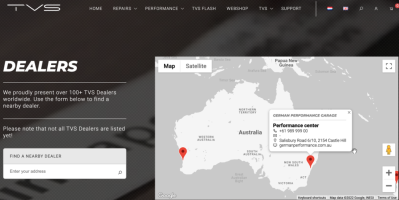

Hi Lox, I appreciate the lengths you have gone to in supporting me on this issue. I hoped I might find a TVS dealer in Brisbane. It’s a 1600 km round trip to my nearest dealer north of Sydney but it’s a start. I’ll keep hoping one shows up locally. I’ll ask the garage I’ve been speaking to if he knows of anybody. I’ve decided to have the 40000k service done through him and he says he’ll supply me with a list of installers he recommends. At this stage, I don’t know what brands he has in mind. Regards, John
ha yes, maybe the TVS dealer in Sydney might fly a techie with his laptop over and do it for you?

Interesting. I don’t know the software version I have but will ask. I have found a TVS installer in Brisbane and will call them on Monday about a drivability dsg mod. TVS says all dealers are not included on their dealer locator and they got that right.The local garage took some finding.
