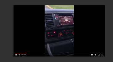

Can anyone help with this terrible creaking sound that seems to be coming from the from front of the van. Sounds like a slow tempo frog ribbet . I’ve tried to attached a Video but the forum keep saying error.
Update: video of creaking here: 76b080f3-14f4-49d6-8dc8-87dca2e825bf.mov

put the video on youtube - then drop a link to that here.
or.
post a link to your online video from your phone gallery app, like google photo or iCloud on apple.
