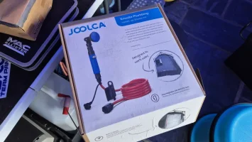

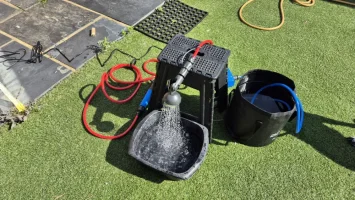

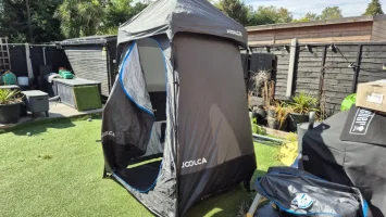

Joolca shower tent. - with pump n stuff
"You just pop - pop - pop, . . pop" - Mrs @Drive Wayne
we have the popup tent - which is awsome.
we have the USB shower pump, folding bucket etc etc
but linked the look of the proper Joolca version.

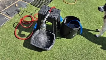

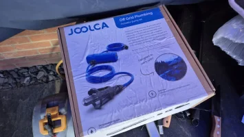

we got the shower attachment.

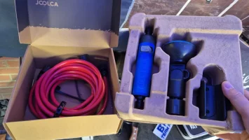

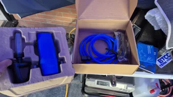

and the 12v Pump . . . . . (no internal battery - it has a long 12v lead with plug)
hooking it up for a test. . .

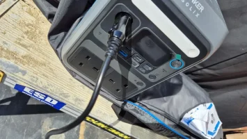

powered off this Anker C300 PPP.

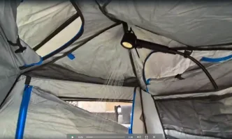

the shower attachement has a on/off switch which stops the water.
the pump then auto shuts off under pressure.
a ver nice setup to be fair.
i left it running, to see how long it would take to empty the 20L bucket.
the results are in . . 3mins 44 sec.
to empty the full 20L bucket.
so a lot stronger pump and much better shower head outlet, - but at the loss of runtime for the lower power USB pumps.
that pump less water - but run longer.

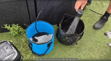

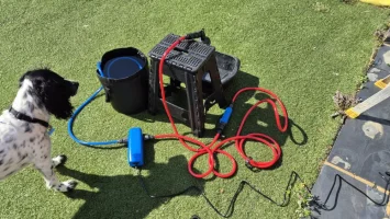

The USB pump version. . .
pump
bucket
test2
USB Pump with a 20L bucket full of water.
setting 5 - 3min30
setting 3 - 3min44
setting 1 - 6min20
xxx
After 10 buckets of 20 l the battery still showing 40%. - so good for a whole weekend.
pump
bucket
View attachment 302393View attachment 302394View attachment 302395
test2
setting 5 - 3min30
setting 3 - 3min44
setting 1 - 6min20
xxx

an Anker C300 in this case.
charge data:
the battery was already full.
I've set the charger to 30A for now.
i left the charger connected over night,
looking at the VRM data the PPP lasted till about midnight before going flat and shutting off.
at that point the charger was giving around 2A to run the loads, after the sun went down and the solar dropped out.
