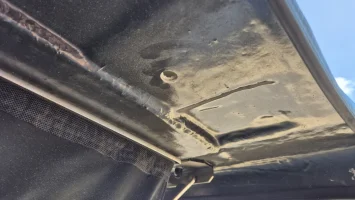

the plan was to put vinyl down anywhere any sticky stuff went.. . . .
so that's what we did, I'm planning on using VHB Velcro to stick the panel to the roof.
this will allow:
A - easier removal in future as it has a 5yr warranty
B - allow for better thermal expansion of the panel, ie it can breath with the heat
C - less damaging to the van
out with the Velcro then. - i had the 50mm stuff that i use all the time,
i got a 10m role, and used what's left of the 5m role.
hook side on the roof,
loop side towards the panel.
them we are planning on a Tigerseal bead across the front lip and possibly don the sides,
and definitely leaving the back side fully open.
we used coke cans to hold the panel up off the roof while it was lined up.....
this stuff is SUPER sticky !!!! trust me.

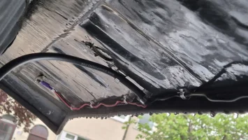

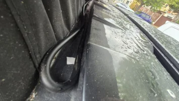

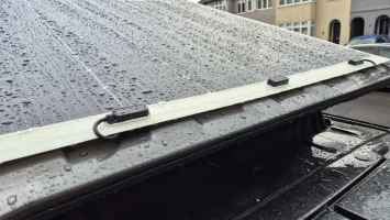

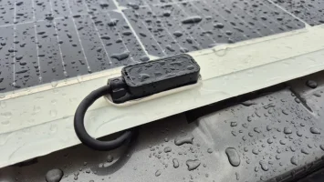

-- Wiring it up --

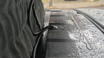

the panel had the standard 4mm PV cable and MC4 connectors. - i cut the MC4 off.
now i much prefer the REAR-JUNCTION-BOX style, but that wasn't an option.
so i wanted to make it as neat as possible.
and definitely didn't want those awful cable gland entry boxes, i loath the look of them.
so i drilled a new hole under the panel.
then sealed the cut fibreglass roof holes with a matching grey nail varnish.
the cables tucked neatly under the panel in the low trough,
then used a metal crimp tube to the 4mm flexible twin core id run in.
with some fetching purple adheisive lined heat shrink.
and some sticky feet style cable fixings.
the cable had a nice wide C shaped loop, to alow the roof to drop without stressing the cable.
then through the old hole into the van.
while i was there i added a second twin-core cable, that will be used for the POP-TOP LEDs when i get round to doing that. . .
for now ill leave the cable up there.
this was the old hole, we used the Tigerseal to seal it.

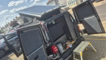

luckily there was enough room to get into the rear panel to get at the cables that run down to the MPPT, that behind the fridge. - its 4mm2 all the way back.
a quick power-up and we was rocking..
260W at that point.
which was 37v @ 7A from the panel,
being converted into 18.7A Bilk charge into the ROAMER lithium. - Nice.
that will do. - it would be nice to see 500W+ from the panel, but for that we will need a low-ish battery and some strong sun.
so untill then this will do.

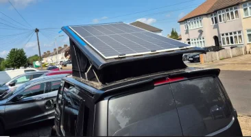

that's it - as big as you can go un a T6 - currently.
the width is maxed out, but the length? - maybe more?
could we see a 600W panel maybe?

-- Wiring it up --

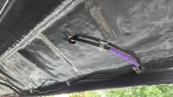

View attachment 291649View attachment 291650

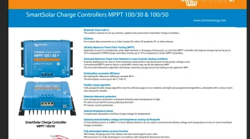

looks like this panel is maxing out the 100/20 victron mppt.
bit of morning sun. . . .
its maxed out at 20A charge rate. . . and only showing 275W
i think i need a bigger MPPT. . . the 100/30 maybe?
View attachment 291662View attachment 291663
looks like the 100/20 maxes out at 440w
but the 100/50 will go too 700w.
i might to swap oit for the 100/50 maybe?

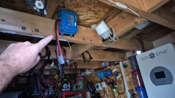

Currently getting the bus to a test.
Looks like 280w is the max I'm gonna get with this mppt.
Was getting 20A of the solar and 30A of the engine dc-dc.
50A going into the battery...... Sweet.
You should have enough power to run 2 beer machines 24/7.
Yes, possibly...... If the sun is shining.
Victron 100/50 - 0rdered
But think I might need a bigger feed for the mppt now. Prob 25mm2 or larger
I'll have to check.
Edit:
Just checked , the terminals are for a 16mm2 cable max.
But I think I would prefer to run a 25mm2 cable and downsize at the mppt with a busbar, or fuse holder.
Or just use a 25mm2 crimp pin.

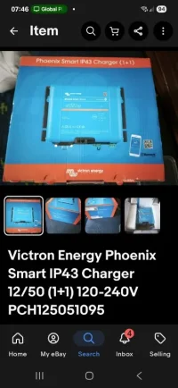

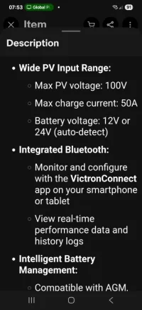

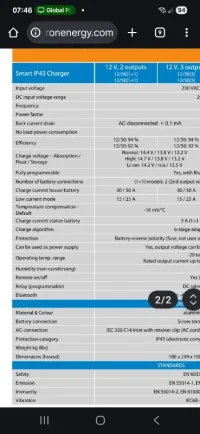

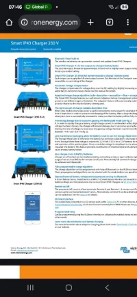

50A EHU mains charger ordered.
Victron IP43 50A 1+1. (For the Cerbo integration)
That's 50A for the leisure battery bank and 4A trickle charge for the starter.
Can be used as a PSU and has BT and profile edit so can be limited for lower charge rates.
Screenshot_20250621_074608_eBay.webpScreenshot_20250621_074638_Chrome.webpScreenshot_20250621_074651_Chrome.webp

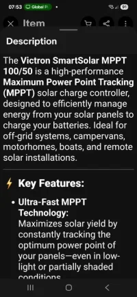

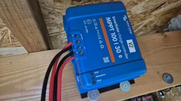

700w MPPT ordered.. -- Victron 100/50
I've maxed out the 100/20 with this new 530W solar panel.
And the 100/30 mppt is 400w odd max.
So I need to go the the next level to get the full potential out of this 530W panel.
That means the night Victron 100/50 mppt.
I've already got a couple of 100/30s which are perfect for the 400w portable solar suitcases.
But for this 530w panel we need bigger.
This campervan project seems to be getting more and more extreme in regards to the power side....lol.

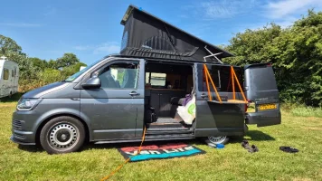

The van done great at camper jam getting us through the weekend with 4% battery remaining at the end
Just an update..
The 50A EHU charger is in
The 50A MPPT is in.
The Roamer 230sb is delayed..... Boo.
But the van is in the VW garage getting the EGR cooler fitted.... They've had it a week now, but hopefully should get it back tomorrow.
Then on with the upgrades before T6FORUM Summer Camp.
