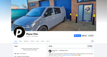

When we bought our van, the bloke that we got out from showed me around his own van and I was really impressed with the rail system that he had fitted (also Smart Beds). It would have a very nice to have (and one that I'd never thought of before) but wasn't to be as it would have meant another lump of money that I wasn't prepared to spend at the time.
Taking the bus to "Planar Pete" in camberly Surrey.
A FB mobile guy recommended on here, that I've been keeping an eye on for years.
He's now got a proper unit.
He does tons of autoterm heaters in tons of T6s, he's got a T6.1 himself now by the looks of things.
all fitted and tested - very nice,
Today was this lovely 2017 VWT6
•External mount in the factory location
•Retro fit so it looks like factory!
•Comfort Controller mounted on the drivers b pilar
•Modem to control the heater via your phone
•Silent fuel pump
•Heaters fuel feed taken from the vehicles fuel tank
•Drivers side lower cover that helps protect heater installs as the one was hold, cracked and broken
•3 years heater warranty
Planar Pete installed, the heat is on!
1739879098622.png1739879108253.png1739879117586.png1739879129108.png1739879139581.png1739879148592.png
we also needed a new under tray - as the existing one was smashed. - a common issues apparently.
luckily he had one in stock and fitted for parts only charge.
very happy with the quality of workmanship and install quality.
Pete is a Diesel heater fitter machine - no messing around.
i recon he could fit one on a T6 with a blindfold on.
100% @Dellmassive recommended.
I've given him the heads up about joing T6F as a trade member,
in the meantime heres his details . . just say @Dellmassive from T6Forum sent you. - :mexican wave:
Pete -07593 245553
Planar Pete is in Camberley, Surrey.​
@Planar Pete

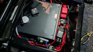

A friend has just had an autoterm heater fitted, the fitter insisted on wiring direct to the leisure battery by passing the victron shunt despite being asked to wire either to the negative busbar or to the fuse box. Apparently this was to comply with the guarantee - complete bulls**** if you ask me. I've moved the connections - how did Pete wire yours?
•Silent fuel pump
View attachment 275029View attachment 275030View attachment 275031View attachment 275032View attachment 275034View attachment 275035
Pete -07593 245553
He would have been where I'd get a heater fitted if I'd not found a van with one as a factory option.
TBF he fitted the ring terminals direct to the battery in the seatbase, the loom comes with two fuses, one on POS and one on NEG. in a holder.
He screwed the fuse holder to the front of the seat base.
no issue with the shunt on this van as im using a GEN4 Roamer battery + Victron Cerbo that uses the batterys internal shunt.
i did mention the MIDI fuse box and the ATC sub fuse box . . . . but same as you he said he would prefer to fit "as advised" by Autoterm - direct to battery.
i suppose it makes sense as a battery connection is a known good - where as a vans 3rd party leisure electrics are an unknown.
im sure they may have had loads of issues with owners poor electrics in some vans.
no probs though, i thought id leave it a few weeks as a test. . . then move the wires and fuses over to my LB setup.
ill probably cut the fuses and ring terminals off, then connect the NEG to the NEG Busbar, the the POS to either the MIDI fuse block, or the ATC sub fuse block.
I'd think it's this, it'd save loads of after sales issues where the heater isn't working when it's down to dodgy wiring and voltage drops etc.
And anyone who does have a properly built and designed electrics set up (rather than a converter installed bare essentials one) won't have an issue moving the wiring over themselves!
