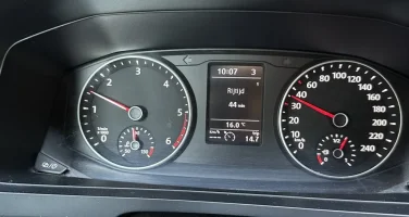

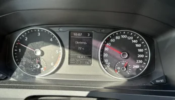

Does anyone know what temperature sensor the OBD2scan is reading from correctly?
I am driving a 2017 T6 110kw.
I noticed a few months ago that my gauge of my coolant was very slow to warm up and in some cases did not even reach 90.
My mechanic told me my thermostat was probably broken.
After a repair of almost 2k further with a replacement of the electronic thermostat, water pump, distribution and so on, I notice that there is definite improvement but it is still more sluggish to warm up than it was before the problems. If I don't do highways it takes almost half an hour until the gauge gets really to 90. On trips through the village the gauge does not touch 90.
When I read the coolant temperature with an OBD2 scanner it comes up that the coolanttemp is only 72 degrees. Even though the gauge is at 90. is this normal? My mechanic says there are multiple sensors in different places in the engine which can cause the temperature to vary.

The difference between OBD readout and the gauge is normal. The gauge is weighted to hover at 90 from about 75C onwards, I suppose to ease drivers from not panicing over slight water temperature changes.
Here's how the water temperature looks like in <10C outdoors temperature in mine (blue curve), the actual 90C water temperature is reached at about 20 minutes of driving but gauge will show 90C already before 15 minute mark. This was countryside driving, varying but about 80km/h.
