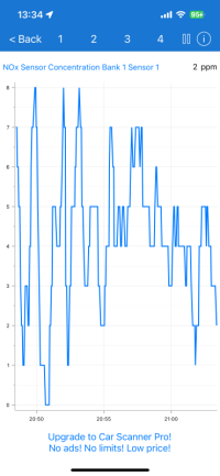

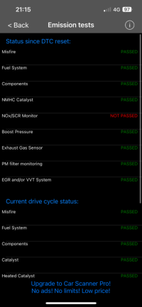

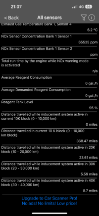

I'm waiting for a Carista to arrive today but do have a different OBD reader. I can see in there that is says ECU software version is 6168, which I think means it already has the right update (attached)??? I also noticed that the 'NOx sensor concentration bank 1 sensor 1 reading on my OBD was showing as 65535 even with the engine turned off, and again sat with the engine running for a few minutes on the driveway (max possible value?) (attached image). In the emission test section of the app it states 'not passed since DTC reset' against NOx/SCR Monitor (attached image). I will get the engine up to temperature later today and repeat the NOx sensor reading with a warm engine in case it is just related to engine temperature.
65535 (hex FFFF) is more just a "sensor not ready" indication. It will come to life when warmed up - takes some 10-20 minutes to reach operating temperature. Your engine doesn't have sensor 2, so that channel will stay silent. Some fancy details here:
Indeed, clearing engine faults also clears emission readiness statuses to "not passed". It can take some time to get them all passed - mine typically needs 250 km for the last one to "pass" (depends on number of ignition cycles, hot enough runs, etc.)

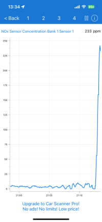

Post-test drive follow up. NOx readings kicked in once the engine was up to temperature (after 10-15 mins). It tends to sit around <10 when bimbling along, temporarily increasing up to 200-250 when I floor it. From what I have read online, these are normal levels and suggests that the sensor is working (or at least it was during the test drive).
