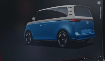

Well... there are some options following VW's latest trends: (ignoring the sill decals)
1. Edition 30 blacked out roof + blacked out A and D pillars.
2. Blacked out A and D pillars - Range Rover/Mini style.
3. Black topped two-tone.
4. California pop-top in white/do nothing).
And the winner is
Number 2
But with white D-pillar, with decal design details:
