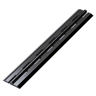

I used 2 hinges as one was not long enough, be aware that the trim is not flat so a completely rigid piano hinge will not work too well.
The removable trim at the front of the storage area needs to be removed and be cut to a straight edge to accept the hinge, simple enough.
The hinge is bonded to the trim to avoid screw holes.
Bonding the hinge to the trim creates the only datum for taking measurements for the sheet as the sides of the storage pocket are not straight and have also radiused corners. It took some time to get the fit correct (get your vice as close to the van as possible!)
