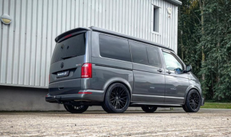

I recently fitted Stance+ coilovers on my Caravelle. I've done about 3k miles on them thus far and very pleased with the ride. Stance get a bad rep on here but I've had a lot of modified vehicles Inc a T5.1 Shuttle on Bilstein/Eibach suspension and the Stance give a very good budget friendly ride.
In the picture they have a good 30mm more to drop but I tow a large Caravan so didn't want it any lower.
That looks quite low, what size rims have you got there
20" wheels. It's probably 60mm lower than stock but as said before there's a good 30mm of thread left on the strut to wind down if I wanted to go lower.

Drop will be dependant on your wheel and tyre specs. 60-65 mm is probably the max you want to go to avoid scuffing on the front, but directly related to wheel/tyre combo.
