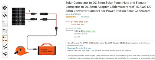

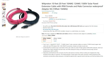

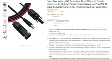

for the solar panel side MC4 is the standard connector.
you can buy them pre-made or make your own.
@Dellmassive . I did do a quick search but nothing turned up so many thanks - it looks like even an idiot like me could manage that if necessary. That said, I now see that Jackery prices have gone back up again from the 'special offers' that were out last week so I'll probably wait until they go down again before buying as I'm in no rush. By the time that happens, I might even have decided to convert over to Lithium for the van leisure system but that requires a much bigger cash outlay as I need the new battery and at very least a replacement for the Ctek 250SA as my understanding is that it's not lithium compatible. I've not even looked into whether or not my Victron Bluesmart IP65 would be OK yet. Again thanks for the advice as always.
