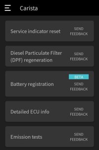

I am, however, seeing some random data against an OEM AGM Varta Battery, though am working on the principle of "if it ain't broke..." so leaving it alone for now!
Ah thanks both, I notice on your screenshot mlh677 that it has beta above it think I remember reading about beta but not sure how to access it ? any ideas or was it just there for you ?

Following the link you sent I offloaded my Carista app version allowing me to download the beta version, which they have added the battery registration function for test and report.
Think that has worked ! I can now see my old battery data in the beta version..so later today I will try and input the new battery details when I swap it over.
