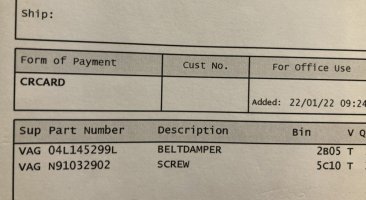

A new tensioner and belt from vw is £120ish, you'll save some money if you do it yourself, it's not a hard job. I did one on my sisters t6
