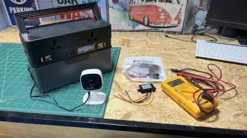

Needed to buy a step down 12v-9v to power the security camera that will be mounted inside the van.
The Allpowers will be trickle charged by an ignition live - will investigate solar options too but not sure I want to mount anything to the roof of the van and the fold up panels intended to be used at a camp site won’t be any good either. Trickle charge input is a 5521 Jack plug

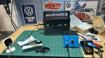

Some bench testing....
The Tapo camera is running from the AllPowers through the 12v to 9v step down and it is not even registering any drain - so must be below the wattage required to register on the display of the AllPowers.
So the Tapo CCTV camera has been running from the AllPowers on the bench for 24h and the display on the AllPowers still shows 100% o_O
I can install this in the van now and should get several days between trickle charges if required.

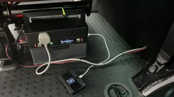

On the driveway it can connect to my home Wi-Fi, but away from home I need some mobile broadband in the van.
Installing mobile broadband in the van is easy enough - bought one of these, with a data sim and a 12v to USB adapter to charge it.
The wiring will be hooked up to the AllPowers and then I will hide the 4G router somewhere in the van - but will need to think about the signal being blocked by the metalwork and all the silentcoat sheets which have foil on them.

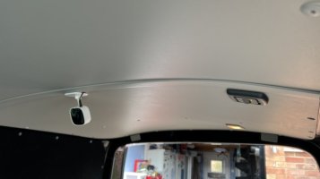

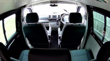

Before you all say the obvious (not very secure as you can just turn it off or unplug it :rolleyes:), here is my CCTV camera install.
It is a Tapo 3MP camera that is running from my AllPowers via a 12v-9v step down.
At the moment it is only connected to my home Wi-Fi when on the driveway and I can view the camera from the house/get alerts - however, I have also bought a mobile broadband dongle/sim to install in the van so it will be connected to the van internet, so I can view the camera from my phone whenever I leave it e.g shopping or on a day trip.
So the reason for the switch?
It is configured to record motion to the local SD card but it also uploads to the cloud. If it is active whilst driving then it will be constantly uploading shed loads of clips to the cloud filling up the space and rinsing my SIM card data bundle in a matter of hours.
Whilst the van is parked I can switch it on and when I go to get in the van I can switch it off.
It doesn’t matter if someone breaks in and turns off the switch (assuming they knew what it was for) or pulls out the power lead as it should have saved their mug to the SD card and also the cloud - so even if they remove the SD card it should still be visible online.
And the reason it is not just connected to ignition live is that I couldn’t work out how to do it so it was connected to the AllPowers/leisure battery - although thinking about it now I could probably use a relay with the ignition live triggering the switched power taken from the AllPowers.
If I ever change it to be ignition switched then I will use the switch for the additional LED lights running from the AllPowers that I intend to install next.
