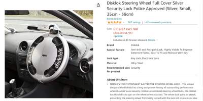

step2 - Steering wheel physical lock (£20 - £150) - Stoplock HG 149-00 Pro
get a steering wheel lock, yes these can be removed by hack-sawing through the steering wheel, but its just another layer. stay away from ones that have a circular key as these can be picked in seconds. The autolock ones have be around a while and will add just that little bit of time required to get it off before the van can be driven....
The Disklok is also popular - https://amzn.to/3ZTKMig

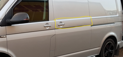

6 - side slider AMOUR Guard - (Pivot Plate) (For Panel Vans with tools inside etc )
They look like this:
more info here:
edit 2023:
additional info . . . Sliding-door break-in
