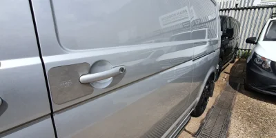

I had similar at the handle side of the door ..
I had a stainless steel plate fitted to the new slider.( They do one to cover that area too)
See here:

After the body shop fitted my plate.
We removed the inner door card again and bonded various layers of additional 3mm plate steel all the way along the beldon cable route.
In an attempt to protect it.
Its just another layer of protection that will add time to gaining entry.

(they also do plates for the rear doors, but so far I've not seem any attack vectors from that angle)

new door and lock etc . . . with the Armour guard. .
the next mods were . . .
to add layers on steel plate . . . along the beldon line right up to the catch pin.
we built up 3 layers of steel using fire mastic as adhesive, which is semi fixable when set, so that will give them a good challenge to get through.
i think the rough thickness of the door is now about 35mm.
we also unhooked the Beldon and reclipped it allong the middle of the steel plates. . . . so its not in the expected location.

When I had my van converted, I discussed security with the converter. He said as part of the conversion they use the cutouts from the windows to make a plate to sikaflex to the inside of the sliding door, to reinforce the area in question.
