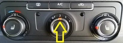

As the weather is warmer than in February and also more daylight - I'm wondering if you could do following and plot starter battery voltage (using BM2). Would appreciate if others could do the same @Ayjay @Big.mac ?
Before starting the engine set the blower speed selector to "2" and keep it there during your run. May use also settings 3 or 4 but absolutely not the setting 0 or 1. Also outdoor temperature should be above +15C.
I'm interested to see what's the lowest voltage during the runs (when engine is running - so preferred to have stop/start disabled). Mine seems never go below 13.3 Volts.
Thanks.
last 9 days . . . (Blower normally set to 1), (stop/start enabled mostly) (local temp mostly above 15C in daytime)
I've found that if battery is full (80% up) then voltage will rest around the static battery voltage during the day while driving around etc 12.6v.
switching stuff on, like blowera or LED lights etc will cause a slight rise in voltage to around 13.3v ish.
regens and large electrical loads will cause an increase to around 14.9v
Screenshot_20200612-192455_Battery Monitor.jpgScreenshot_20200612-192459_Battery Monitor.jpgScreenshot_20200612-192505_Battery Monitor.jpgScreenshot_20200612-192509_Battery Monitor.jpgScreenshot_20200612-192512_Battery Monitor.jpgScreenshot_20200612-192516_Battery Monitor.jpgScreenshot_20200612-192519_Battery Monitor.jpgScreenshot_20200612-192524_Battery Monitor.jpgScreenshot_20200612-192527_Battery Monitor.jpg
Thanks. I do see the same - but only at setting "1". Just have been wondering quite some time now that setting the blower to "2" or higher seems to set charging regime to "old school" charging. I have kept eye on this quite some time and this far it has worked this way without fail - minimum 13.3 Volts (certainly goes up to 14.9 at recuperative braking or DPF regen or certain consumers - heaters etc.).
