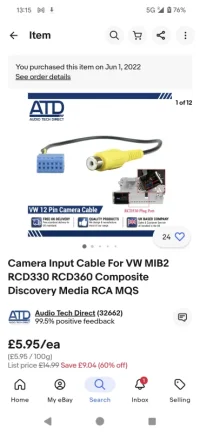

I used this, although it was only around £20 last year with a £6 adapter form eBay straight into my std VW screen. Coded using carista. Works exactly as std VW with optional lines and overlay. 1000018988.png
I used this, although it was only around £20 last year with a £6 adapter form eBay straight into my std VW screen. Coded using carista. Works exactly as std VW with optional lines and overlay. View attachment 230426
nice,
got a pic of it fitted?
and the navi screen pic?
and a link to that cam, and the adapter?
