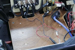

Oh a gnats more wood.....this bit holds the inverter I started with a complete floor template tightest of tight fits............and then paired it back an back........can access all seat base bolts on a vert plane but it's damn tight it works to pull all the neg wires up to neg bus an' shunt an only took a few cuts in the mat..it's all supported in fact both SB's are supported from existing holes.sure some made wider to accommodate riv nuts but hopefully structural integrity hasn't been compromised
52234724535_4af5e1ef0c_o.jpg_S2I2458 by Stuart Philpott, on Flickr
The blank ali plate holds the vic orion tr smart 12 12 30........heat and this gizmo have been haunting me for eons...in fact researching the orion's heat is why I'm posting here
so to the left of that is part of my final work around.we will see where that all goes..it's a preddy powerful fan...now run off a temp sensing relay which incidentally I finished install of this very day....... I've also hopefully installed a manual B2B cut off...which I have reasons for beyond the heat concerns of said B2B. this shebang is really a work in progress right now......sort of akin tto the whole build ethos really only now tis leccy not wood
52234234716_7b3ddb55de_o.jpg_S2I2481 by Stuart Philpott, on Flickr

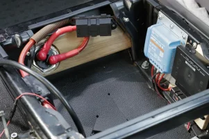

Petty much all good on the leccy. lads ...didn't get quite as far as I'd of liked damn my web speed is slow....we are abit out in the sticks so updates can taken an absolute age lots of failures and start overs..........but no hairy moments ............. some naivity sure,but a bit more ground work and maybe that can be sorted . I think the fan and temp sensing relay set up will work The B2B actually got cooler as the fan kicked in............ cut off switch works inverter works BMV works
Need a one in one out one way diode say 30A max any help?
Hmm this right here is a milestone in a little build.
Note to self it's ok to make a wooden battery and stuff loadsa gizmos around said wooden battery in blind faith an maybe it will just fit like a glove
Rock 'n' roll
52272539341_071982e4ea_o.jpg_S2I2521 by Stuart Philpott, on Flickr
Bit of jiggery pockery to get it in but I'd done that a 1000 times with the mock up just needed to factor in the 20KGs.. . thing is I'd worked out all the angles tip the front in first black of wood to support the back just before fingers get trapped then rejig hands remove wood slide back
Get in
Man that right there is a happy feeling
take care out there guys
stu
