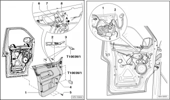

@StudleyGlass door card off, unplug wires out of door motor/module, unscrew motor from door panel (3screws I think) then fit the new one in reverse order
oh there in the door then. so when i have fitted them, what then do i just follow the instructs for the euro 5 models to get then to work?

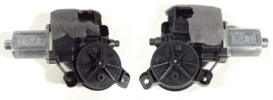

It seems its down to the suffix letter at the end all modules are either 7E0959801 or 7E0959802 dependant on vehicle side, this would appear to be the numbers for RHD vehicle but this is not confirmed just the pattern from the vehicle scans i have/have seen
7E0 959 801 K - Euro 5 non folding
7E0 959 801 L - Euro 5 power folding
7E0 959 801 P - Euro 6 non folding
7E0 959 801 Q - Euro 6 power folding
