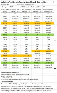

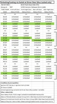

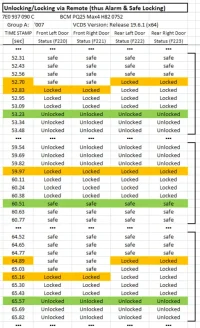

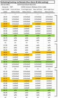

Seems that the actual door switches can't be read directly. Status available is seemingly a combination of several door switch states. Best available sampling rate is about 0.11...0.15 seconds/locking status of four doors (Group 007). Adding another group (e.g. monitoring key press) would double the time. Third group would approx. triple the time.
Anyways, attached a few tables. Obviously need to run the same measurements in winter to see if any additional delays/fluctuations/sluggishness are introduced between state changes. According to VCDS status "Implausible" is one of these states.
Doesn't seem to meaningful to measure the time from "triggering" (key pressing) as it has to be read from different measurement group thus slowing sampling significantly.
Left column = time stamp in seconds.
Orange line = first phase of activated locking/unlocking sequence.
Green line = final phase of activated locking/unlocking sequence.
Safelocking=deadlocking.
