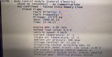

Checking with vag com I have the usual BCM no communication fault 25796.

Screenshot of fault code.

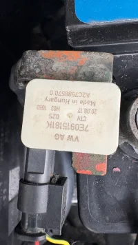

I had a start / stop error for ages, which never threw up an actual fault code of any sort.
Turned out it was the battery control sensor on the negative terminal. Replaced it and everything was back up and running.

The fault code I have and the start/stop might not be related. That is why I wondered if anybody knows what the fault code is actually relating to.
To me BCM no communication could be communication with many things but not sure?
