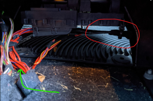

Interesting, I have that unassigned power cable under the passenger seat. I didnt think the cable looked thick enough for 100A. How can I check it is? Where will the fuse be to check?
Thanks
You're right! It might only be 50A. Enough for my purposes either way though.
Thanks
Fuse SA3 in ebox under main battery, 3rd slot from left. Awkward to access, need to remove battery, it’s underplate and then the large plastic cover that goes all the way to small fusebox next to driving light.
Does anyone know why it is there in the first place? And, why only on some vans?
Makes no odds to me as 100A is more than enough for my wee sub amp plans but just curious.

Don't really know but cargo area 12v sockets, trailer coupling and webasto are afaik powered from thereabouts so if you have any of those that might explain. I think you find thinner wires attached to the thick feed if you remove the tape.

I do have a factory fit towbar so maybe that's it. Wish I'd known about it before I carpet lined the van :) would have been a nice easy way to add a cargo area 12V socket!
I double checked some wiring diagrams for T6 and on models with no factory second battery it can also be SA8 ie second fuse from right and can be either 50A or 100A, I guess depending on which all build options are powered by it.
