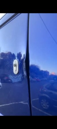

I have seen other vans on the road with locks that are fitted into the doors so all that is exposed is a small lock as attached image.
What are peoples thoughts on these?
Is additional mechanical security required on 6.1s? Or are they already difficult to gain entry to?
Are these locks prone to making the van rust as metal needs to be cut etc?

IMO it's the sliding door that needs one of those locks as the normal deadlocks are fine on the front doors. The sliding door has a weakness exploited by thieves when they drill a small hole and pull the cable to release the catch.
My T6 has been broken into. Its very quick and easy when you know how.
I now have deadlocks fitted, and last time, they did not get in due to the extra locks.
They also did about 5k of damage, whilst trying, but got no tools.
I've just had some fitted to a Vivaro, which also got emptied last week.
Locks were £150 each, fitted. The guy did say, if I called direct, they would be £100 each.
Depends if you want your van damaged or emptied of tools.

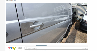

i had mine done, but didnt want to go down the dead-lock route.
but DEFO went for the side door plate ( as @Loz mentioned). - Beefing Up Your Vans Security - How I Done It -
we had the repair done via the insurance (whole new slider and side repaint one panel either side) and asked them to fit the plate as a small extra.
Them added my own extra internal security to protect the beldon cable and catch release.
we had the repair done via the insurance and asked them to fit the plate as a small extra.
View attachment 143790View attachment 143791
I agree they are a deterrent.
I had them fitted to a Sprinter & an Lt after they were attacked. I've just had them fitted to the Vivaro to cover the damage also.
The Vivaro ones came with an internal plate, which should provide a small amount of additional cover.
Truth is they are very easy to work around, and probably add just a few seconds for someone who knows.
As far as I remember, the one for the side loading door has a bend, which goes over the thumb grip handle.
Its a weak spot.

They come with 4x studded rods welded to the back which drill through the outer door skin.
These have rectangular load spreading back plates. ( Fancy washers) and nyloc nuts which bolt on from the inside. They are measured so they don't interfere with the internal lock mechanism.
The back of the front plate has 3mm neoprene foam... This is to take the play in the curved van panel as the plate is dead straight..... Instructions stay don't over tight en.
Its a weak spot.
There are two plates available.. one for left one for right of handle.... (Imho only the left side is required after inspecting our van after the break-in(if you have deadlock s))..
But we did add additional internal measures to protect the beldon cable from any external drill & pull attacks.
