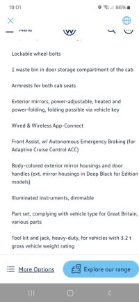

Just had a look at the brochure and according to that all 6.1’s have app connect so CarPlay and android auto should be available. Composition colour wired and discover media wireless.
Pretty sure you should have CarPlay if it’s a 6.1. I would go back to the dealer- I’m guessing it wasn’t a vw dealer?
