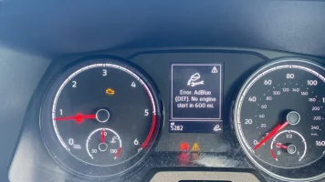

Got home earlier then wife got in van to drive off but a warning appeared, I can’t remember entirely but along the lines of …..Adblue **** range to stop 650 miles.
I misread and tried topping up Adblue but barely got a litre in and seemed to be spilling over, I didn’t push that action any further as aware of overfilling issues. The van now says Adblue range 600 and still shows eml and amber triangle . Van has only done 5200 miles . Adblue low or Adblue fault? Mostly short journeys but with long 200+ mile journeys for camping last couple months so I don’t see dpf
issue yet. Any thoughts?

What's the engine code? It's on the configuration sticker under dash. E.g. something similar to CXFA, CXEC, DNAA, DNAB,...
Details say CXHC engine code
A kind of surprised to still see the fault on MFD = the fill up+tool symbol and range without the fill amount. Also the emsssion light caught my eye.
Booked in with dealer at earliest a week this coming Monday on 26th.
Please keep us updated. Especially interesting would be to see the fault codes.
