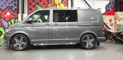

Over speed tables at approx 15mph and my tyres are hitting the inner wheel arch liner on the front. Evidence of rubbing is very clear on the plastic trim.
Bugger ! Now what ????
@BognorMotors may be well paced to advise; I think 265/40/20 are seen as the optimal tyre size regarding the aboveNot sure about offset, I know they are wider at the back 8.5 front and 10 rear
20x275x40 profile tyres and NOT going lower.
The only time it has rubbed is going over speed tables, approx 15-20mph. The tyre has rubbed at the outer edge of the wheel arch and not the inner liner section so not possible to heat and bend, remove it ?
With the standard shocks it was horrendous going over the same bump, crashed into it at 10mph and thought the spoiler would hit as it came back down, shocking
I'll be selling a fool set of standard suspension soon with H&R springs that lower 40mm to buy Eibach -30mm I think ?
Beepee one of my customers who also wanted to run big wheels fitted an adjustable camber bolt in the top bolt hole on the T 32 shocks , this means you can adjust the camber of the wheel ( something not possible normally )., Powerflex UK sell these bolts , you just change the top one and its got a cam on the bolt which allows the wheel alignment to be altered to stop the touching on the outside of the wheel arch lip .
