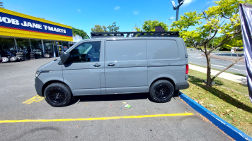

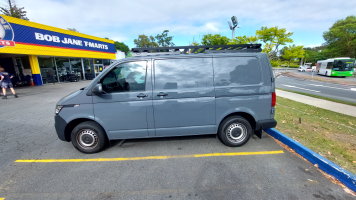

Ok, so I got the wheels installed today.
My before and after:
205/65R16 >>> 235/70R16
Stock steel >>> Fuel Vector 8"x16" ET20
So with this offset my calculations were about right more or less. It does stick out past the fender by about 5mm on the rear and approx. 15mm at the front.
I don't have the wheel arch covers yet, so I'm not sure whether that thickness will be enough on its own to keep me out of trouble. I'm hoping it will but if not I've got two options:
1. Get some rubber stick on flares to add that extra width I need.
2. Or get the wheels machined down by 5 - 10mm to keep them in the wheel arch covers.
In saying this the amount of utes I see driving around with their wheels sticking out by 30 - 50mm beyond their wheel arches are is like 1 in 5. If they aren't getting busted the likelihood that I do is pretty low.

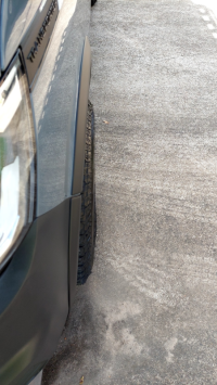

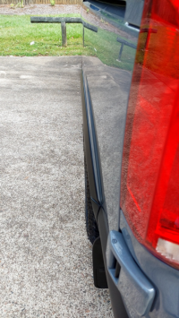

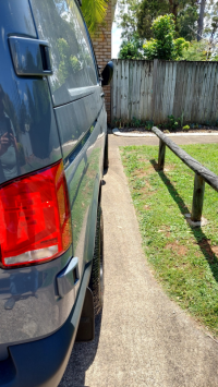

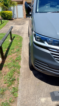

Some photos on how much the wheels stick out.
Like I said it's about 15mm on the front and 5mm at the rear. But I had to use a spirit level and a tape measure to work that out.
Reactions: MrD
I got the wheel arch covers on. And they give you about 5mm of extra width. So my rear wheels are fine but the front wheels still stick out a bit by approximately 10mm. Though it does seem less obvious now.
