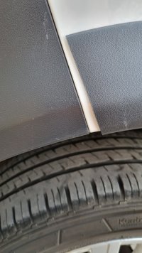

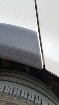

Hi all
I purchased some black ABS plastic side mouldings and wheel arch for my T6.
Having offered them up to the van for a dry fit I'm not very happy with the fitment at all. They don't seem to leave an even panel gap.
I appreciate they are plastic and the fitment with aftermarket parts sometimes pot luck.
Does anyone have any similar experiences with this product? Are the ones on offer from Transporter HQ any different?
I have just purchased some too and think I will be returning them as they are shocking, don’t marry up with each other, the nsr isn’t even the right shape.
How did you get on with yours, did you get them to fit in the end?

Hi all
View attachment 191674View attachment 191675

So didn’t end sending the ones I purchased back but I did order some from RGM and the fit is so much better. However it’s not what I would call perfect. There are some gaps but these are to allow the doors to open and close without catching. If I were to take them off and redo them I’d actually paint or wrap the van where the trim ends/meets up so the colour of the van doesn’t show through as much. I tried with a paint pen to cover some of the gaps. Also I’d take the 3m tape off and just use something like tiger seal as it gives you a bit of movement to get the position right. The 3m tape gives no movement to be able tweak the position.
