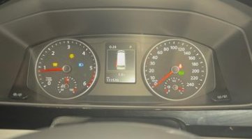

While I was reading, all the icons were flashed once on the dashpanel. After this the ignition icon is begin to blink, the lamp icon is lighting and the car blocked all the assist service.
If the two rear sliding door is closed, the display shows that those are open, and if I open the door, it shows that its closed.
The front lights works incorrectly (LED lights) the right lamp is lighting, the left lights only when I switch to dazzle lamps.
The car forgotten the door opening and closing and I also cannot open the luggage compartment door too.
The buttoms of the multifunction steering wheel does not works too.
