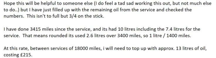

Thing is I saw them refill it to the top the first time it went low, and now only 1/3 on the dip stick left. Small family garage and would be very surprised if they didn't fill it correctly to start with, but it's gone again anyway. Before that I was topping up about a litre in total between services.

The oil has to be going somewhere, the question is where?
If I find out I'll let you know, think it needs a visit to VW. It's the first van I've let go over 3 years old and warranty-less. Got a bad feeling about this.
